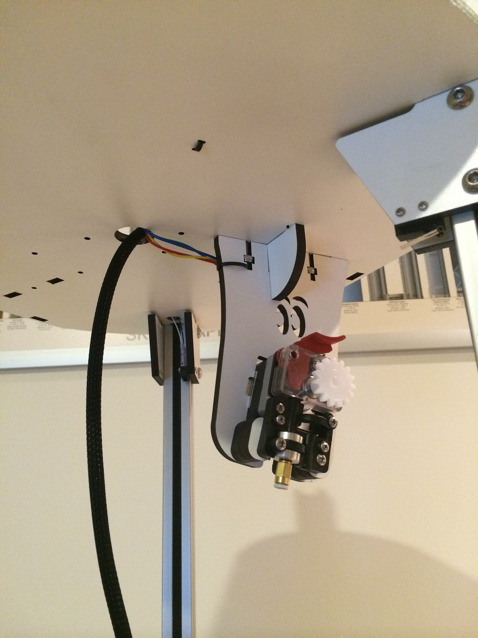

The build continues with a 3hr second wind. Got the Stop switches wired and everything strapped out of the way of each other AND the belts. Installed the belts and put tension on them. You could feel it skip when it was too loose. Thought that was a problem at first. But now the up/down action is super smooth. My total hours are currently: 10:45hrs. phew.
Also got the EZStuder together and installed. So far not an issue, even though the top should be flipped.
I called it quits due to the Hot End not being fully cured with the RTV paste. This will have to wait till another day..
Thanks to this forumn and all of you who have been through this before (maybe many times). A forum like this is very valuable for every stage or experience level.
Have a good week everyone...

Couple things I've noticed in your pics... the top wiring I see all the tape you used to hold down wires, the little double oval cutouts on that top plate are for zip ties to hold the wires =)
next, the top plate is actually on correctly, thats how I have them all on the v2s I've built here at the shop...
Third, you have the ez struder in the bracket backwards.. you want the front of the ez struder on the side where the blinky eyes are in the right direction... and in the first pic on your latest update, the ez struder should be on the left set of brackets, so from the front of the machine you can access the ez struder directly... the way to know its right is when the ez struder is mounted to the bracket and the bracket is on the machine, the larger hole on the top plate (that is used to feed the filament down) will be above the red tab on the ez struder.... hope that makes sense..
any questions feel free to ask, I build em all day every day lol

Guanu - Thanks for taking a look at my build. I always appreciate the feedback. I'm compiling a little list of my own related to the install manual.
On a couple of your points below - Going by the pictures 10-1 & 12-10 within the v1.4 manual would point to a) the top being wrong on my unit, b) the EZStruder being correct (matching the manual). So not sure where the foul up is. I'd love to get some clarity on it though. I see the small hole that "would" be above my ezstruder, if it was flipped to the other side of the mount. But then it wouldn't match the picture in the manual. But that should be easy enough to correct at this stage. Glad I put a quick connect on that 4 conductor cable.

if you look at this pic: https://www.flickr.com/photos/seemecnc/12599727113/ this is how I build them here at the shop, the top plate is mounted just like yours, in this pic, the X tower is the closest one on the right of the pic, and the Z tower is the one on the left in the back... you can see the filament feed hole directly above the ez struder...
The reason I build them like this is the ez struder is accessable from the front of the machine (it is if you do as in the manual too), but this way correctly orients the blinky eyes when you are looking at the machine, so they dont look backwards and dont match the cheapskates.

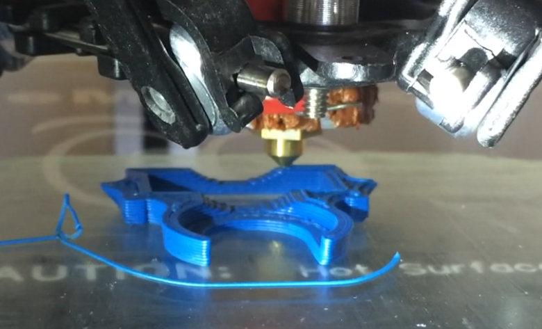

Couple issues on this first print. Any suggestions on the cause or how to fix? I'm sure there is some parameter hidden somewhere that would help.
But for this shroud, these issue are not a deal breaker. I'm gonna clean it up and put it in..

if the loops are just on the overhang, additional cooling would help, though with ABS it can cause its own issues, I'd drop the temperature slightly, possible reduce the layer height a bit, that overhang should be printable.
