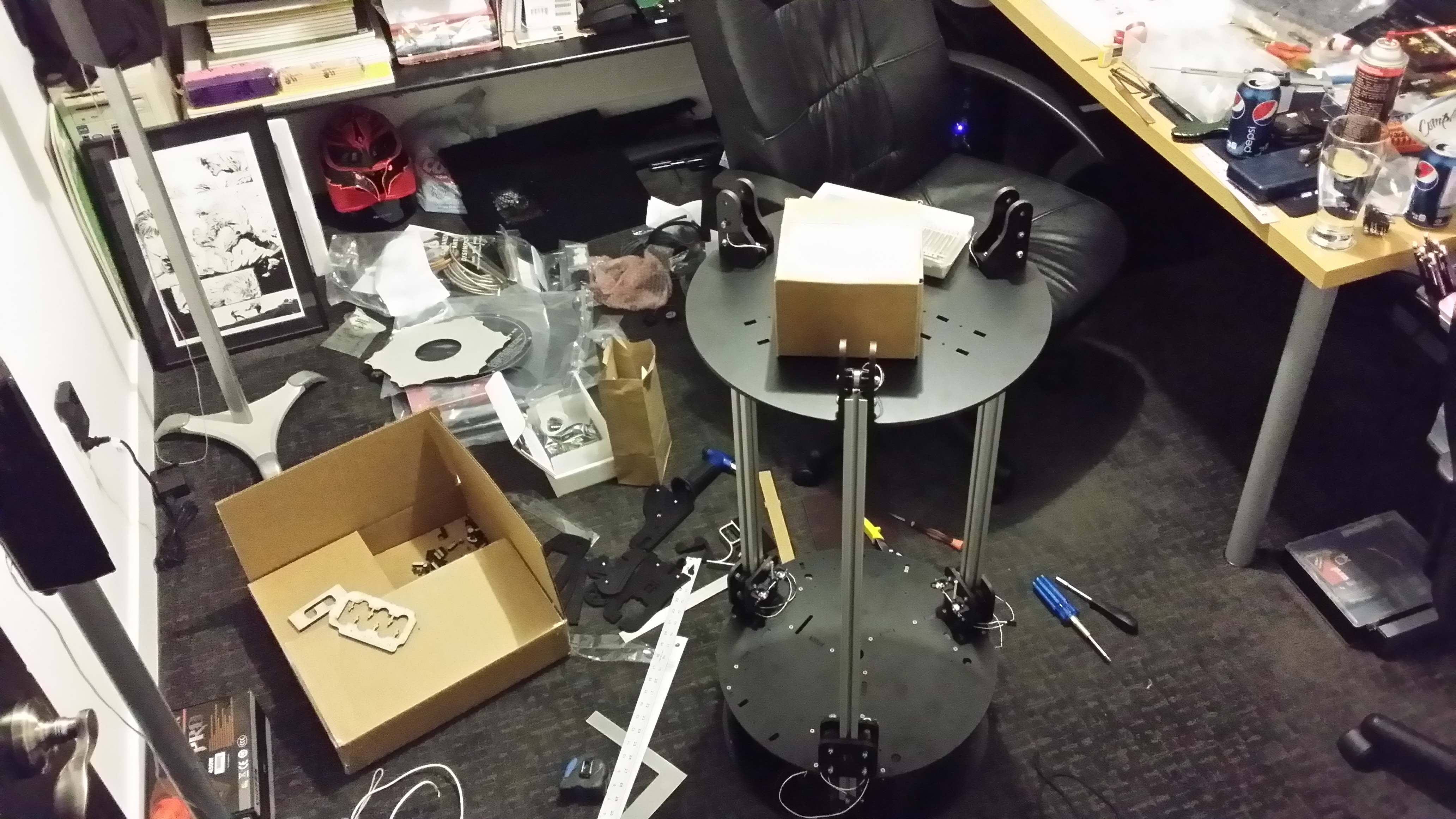

Figured I'd make my intro and first post all in one!
I'm in Manitoba and I'd been looking at a 3D printer for years. Originally I had been looking at the Reprap when it was first coming out, but the lack of software and constant design changes made it really hard to pinpoint one to try. Something better was literally coming out every few days. Plus I was broke and just out of school, so that didn't help. This year I got a few bucks together and decided to take the plunge. I had almost hit the purchase button on a Printrbot Plus, but I saw the delta design and immediately became hooked. I was pretty skeptical about the whole thing as it was so different from all the cartesian style printers, but I read a few things on these forums and talked to John at SeeMeCNC and POW!
On to the build!
Ordered this thing on January 20th (which worked out really well for the V.2 of geneb's assembly bible) at it arrived on February 3rd. From that moment till Saturday February 15th, my 'office' was a disaster zone.
Just like everyone else.
Got all the tape pealed off.  I though the lettering was going to be a nightmare, but I used my thumbnail and it came off easy as pie.

Getting the table top fitted on was a bit of a pain, but it wasn't half as bad as it could have been. Some of the parts were this close to needing sanding, but I figured it'd be better to be more rigid than loose.
Get that table top in place!

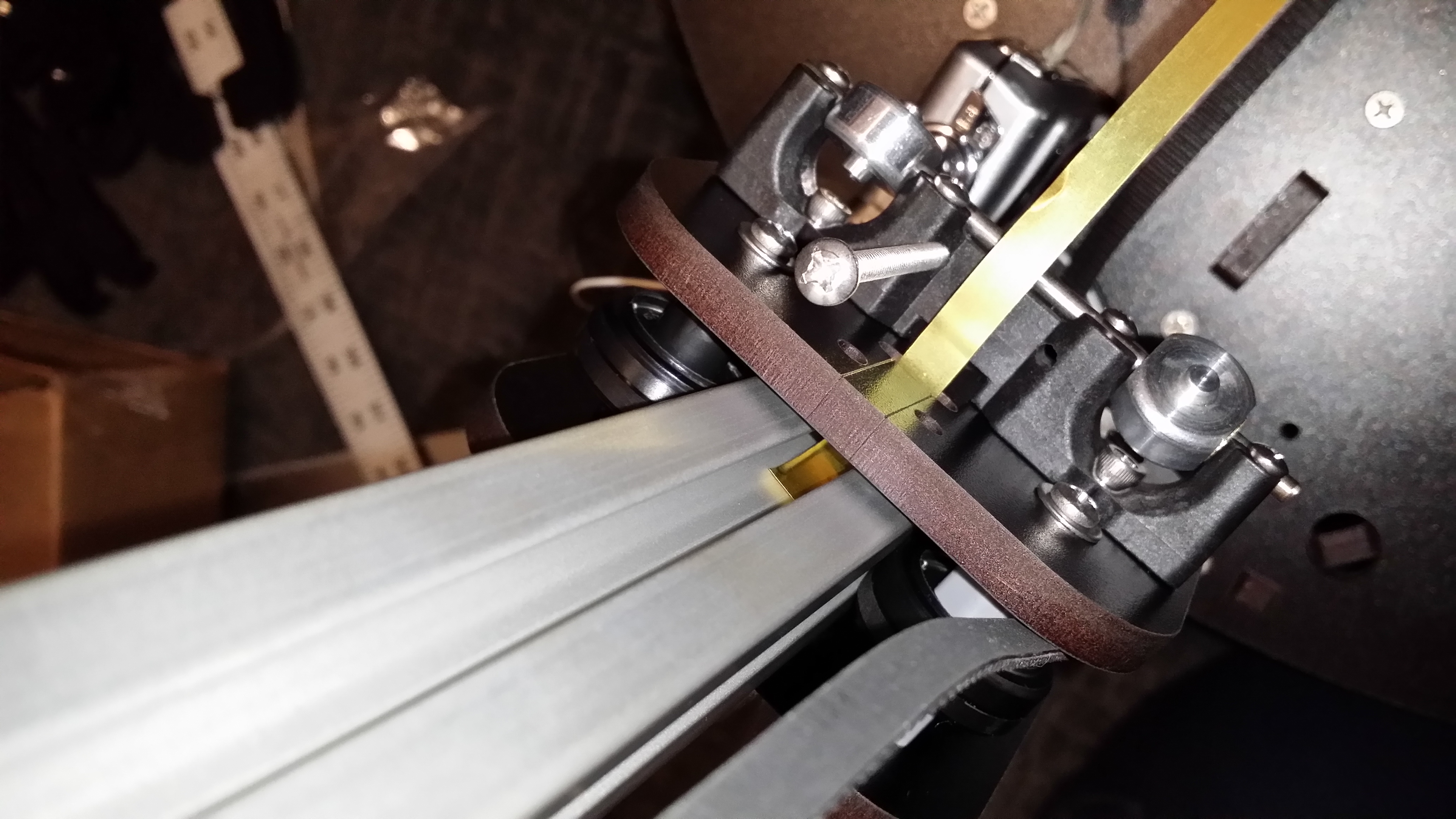

Next I fired on the belts. This was incredibly easy. Popping it down to the axis steppers, the belt naturally fell in front of the lower bearing and I was simply able to grab the belt by hand. No forceps needed. I don't have very sausage-like fingers either though, so for some people, getting those forceps would still be a good choice. I used Dan Barrans method of getting the belts onto the cheapskates and it worked like a charm. Just cut a strip of brass from one of those sheets I got. Some slid right in while the others stuck to the brass and I was able to simply pull them through.
Insert thin strip...
... and BAM!
... and BAM!
Strap those bad boys to the cheapskate mounts, grow a couple more arms and tighten that top bearing to get that belt tight! Seriously though, this could be a bit more one-person friendly.

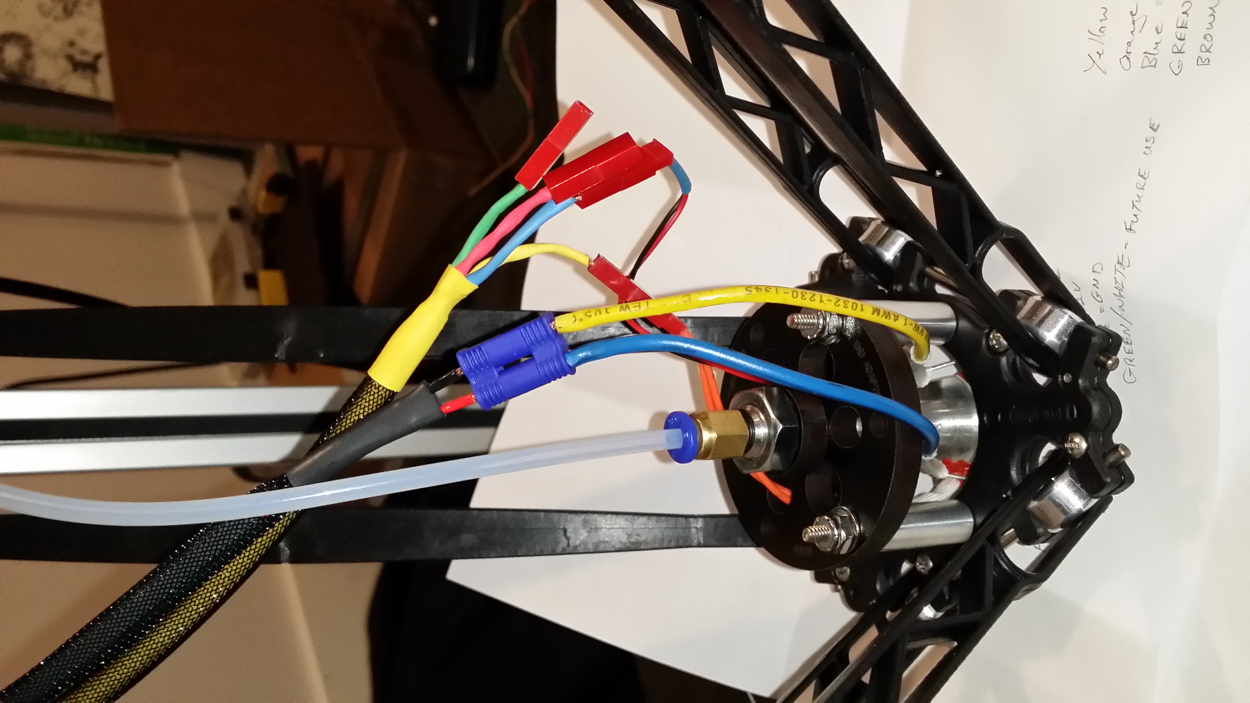

I installed the extension onto the wires for the extruder and left the other end hanging as I wasn't sure how I was going to route it and therefore how long I was going to need it.
I then moved on to the hot end wiring. I knew after reading a whole whack of posts, blogs and watching videos that I was going to want a parts fan and likely some lights. My little office doesn't have the greatest light at the best of times, so for me lights were something I was really leaning towards. Now that I have the machine assembled... I definitely need lights. I can't see jack on that platform.
So the wire count going to the hot end was 3 pair. One pair for the heaters and one for the PEEK fan from the 4-wire cable, and one pair for the thermistor. I wanted to be able to have some options in the future so I also sent down a nice flexible stranded Cat5e networking cable. This gave me another 4 pairs to work with. Now I was able to take one pair from the 4-wire 16awg cable (the one supplied in the kit) and tuck it aside in case I was ever so bold as to want to do a dual extruder setup. Now with the network cable I had 4 pairs. One for the thermistor, one for the PEEK fan, one for the parts fan, and a last one for lights (or other option such as the thermistor for the second extruder). The 24awg wires can (if I've read correctly) carry up to .5A. The fans only take about .1A, so you could likely bundle a couple together if need be. I put a different colour shrink wrap on each pair and tossed on JST connectors.
4 pairs from the Cat5e cable
Yellow thermistor, blue peek fan...  you get the idea.  Marked it all down and made labels for the LCD door that state which pair is for which application.

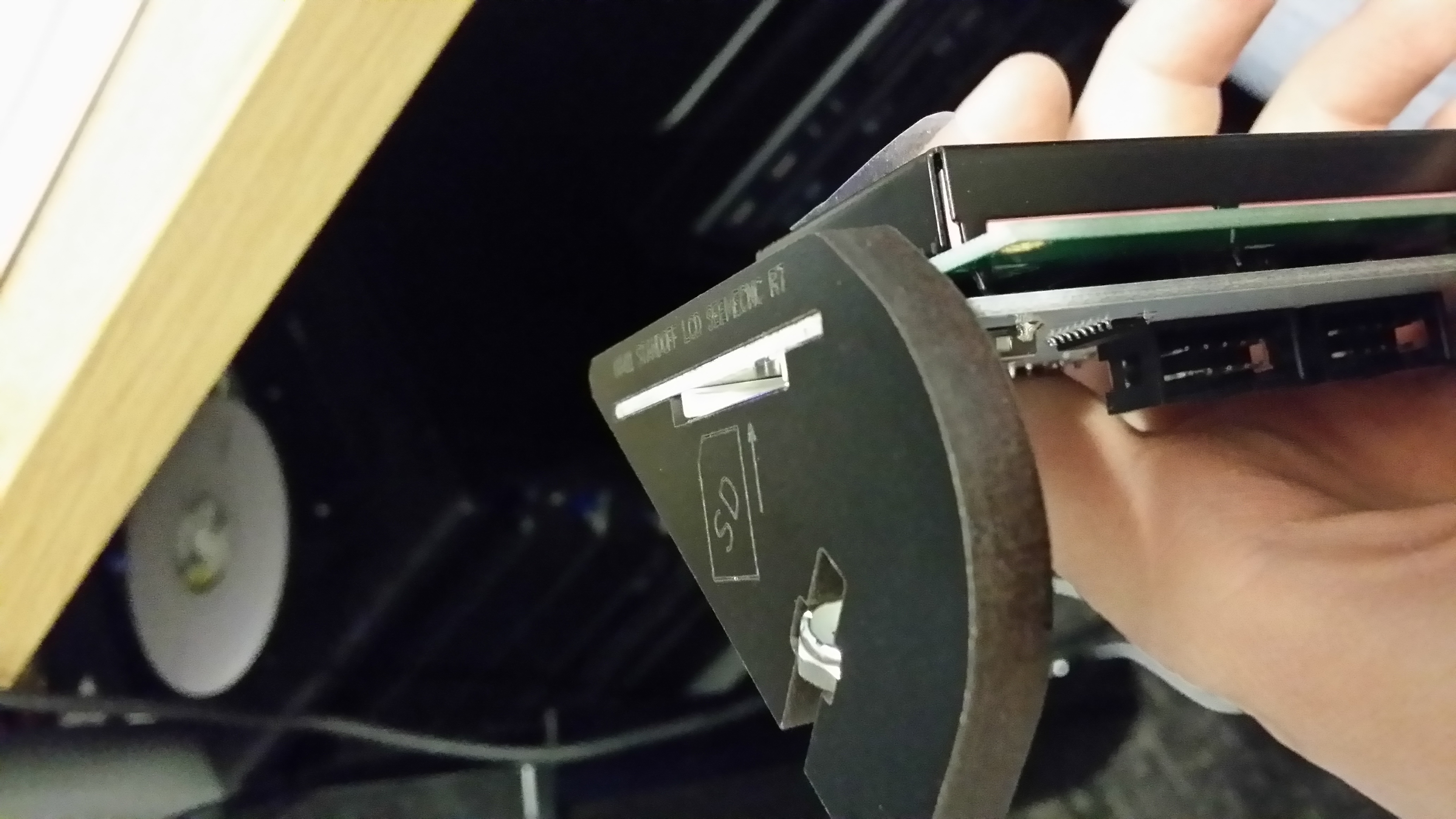

As geneb mentioned in the manual, the melamine is cut for the LCD circuit board, but not the solder joints on things like the knob or SD card slot. I just took a knife and cut away what I needed so that it would go on flat. I didn't want it to 'not grab' one side or the other. It was very quick and easy. Also using a 7/64 drill bit, I was able to drill the melamine and use the #4-40 screws with plenty of grip and no splitting. Just work the screws in nice and slow.
Cut away a few areas so the solder joints will sit in the groove too.

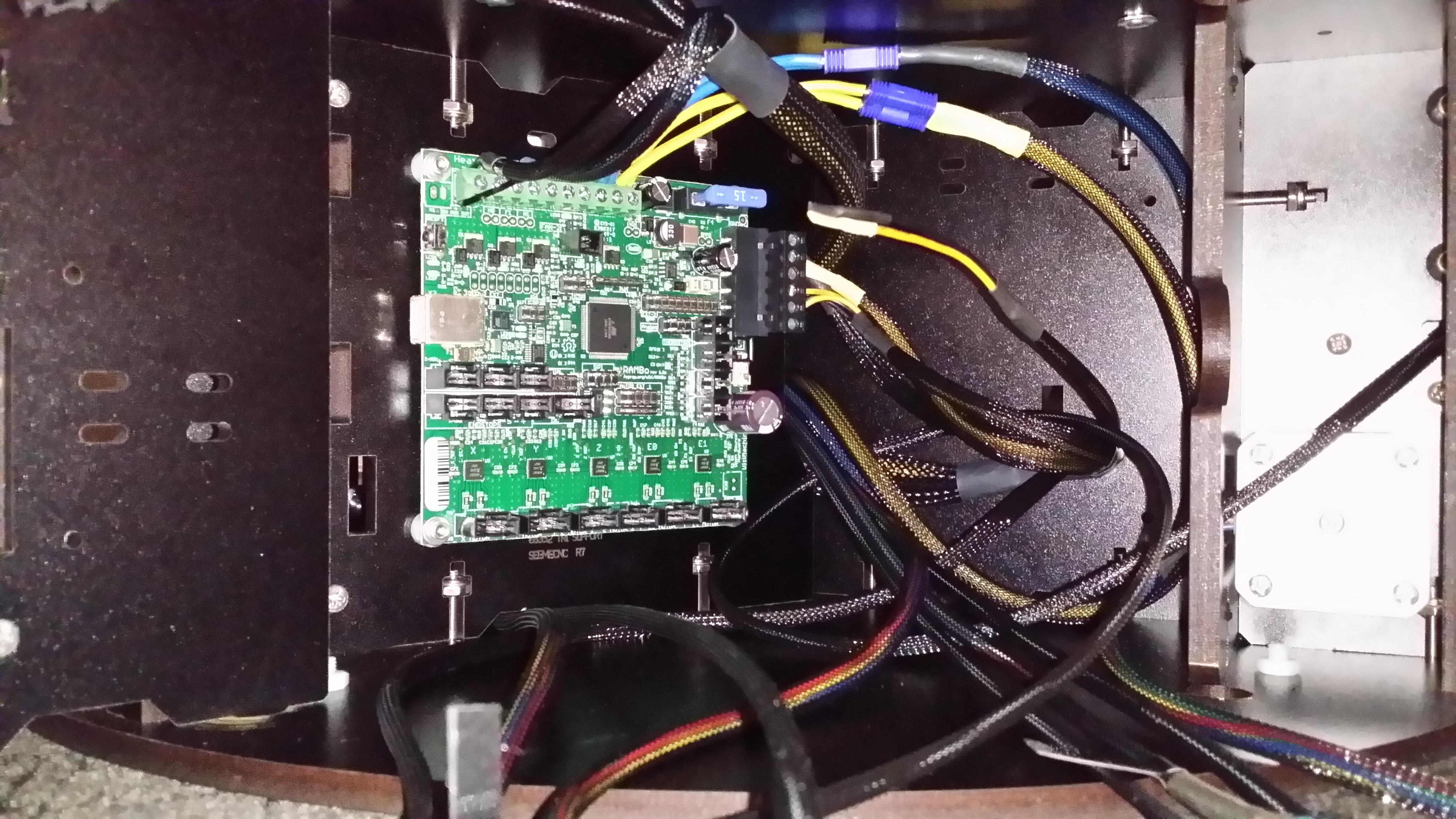

Next is when I installed the Rambo. For some reason I had run out of the 1/2" #4-40 Socket cap screws by this point and had to go buy some more. You can see in the picture the two Deans connectors for the heat bed.
Rambo v1.2 installed and begin wiring.
All wires hooked up and wiring somewhat tidy.  I'd like to install a cooling fan somewhere so I didn't want to fix it all in place until I found out where I was going to mount it.  Any suggestions would be great.

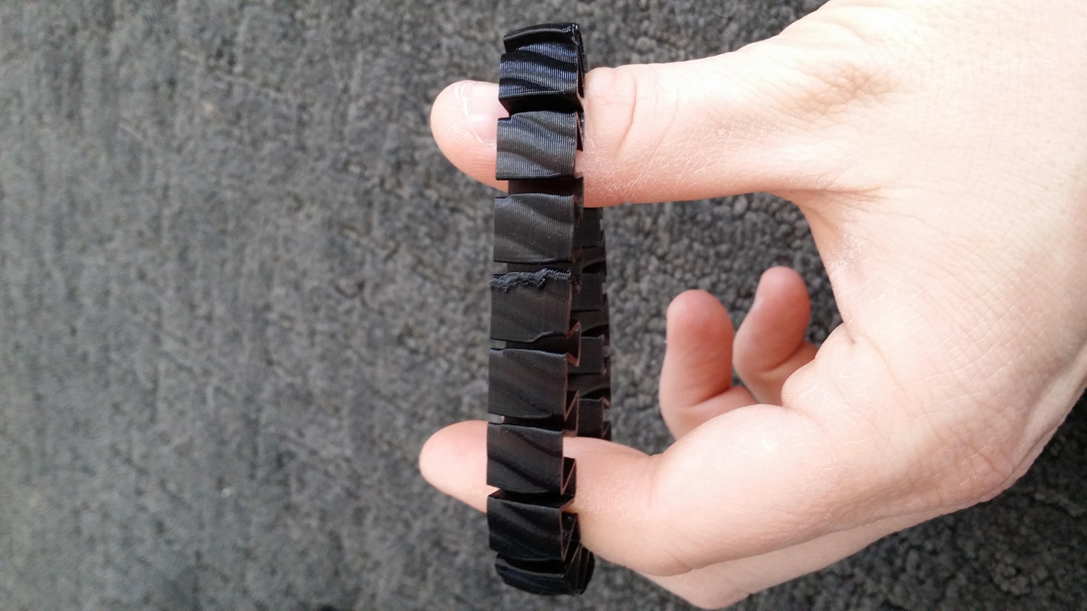

But not so much with this one area. I think this is where the extruder finishes that one layer and jumps up to the next? I didn't have the spiral vase option selected in Slic3r.
What's the deal on the one area?
After I printed that... nothing would stick to the tape. NOTHING. I tried for hours to get something to stick to the tape. I put on new tape, nothing. Changed temp settings of both filament and bed (I know now to not have bed on for PLA on tape). Nothing. Printed directly on glass. Just balled on the end of the extruder like everything else. Then I read that I should wipe down the glass/tape with isopropyl alcohol. I ran out to my snowmobile and grabbed a bottle of gas-line antifreeze (essentially the same thing) and rubbed that on the tape. WHOO!! Now THAT sticks! Prints stay right where they should. When I'm done, get the bed up to temp and the parts peel right off.
A few hours ago I finished printing the brackets for geneb's wire guide. No cleaning done to these either.
Here's where I have questions.
This one has 'bumps' that stick out in places.  I have this on almost all the prints I've done.  What causes this?  It's much more prominent on other jobs.  This is quite subtle.
Any help would be appreciated.

http://www.thingiverse.com/thing:43983
I've reprinted this thing and it basically came out exactly the same.
The 'top side' looks pretty good.
But the bottom area looks like a disaster zone. Is it because of the angle that it needs to print at? I haven't been using supports. I might have just answered my own question taking a good look at it right now...
Or perhaps this might not be the best fan duct to go with? I know there are plenty, but maybe someone has used a few and found one that works best. I just liked this one because it seems like it might curve the air around to get all sides, eliminating the need for more fans. I'd really like to get rid of the house fan. It's louder than the printer when it's running.
bubbasnow
Posts: 1061
Location: Dayton, WA
Re: Tinyhead's MAX Build
Post by bubbasnow »
what temp?
Tinyhead
Posts: 439
Location: Ontario, Canada
Post by Tinyhead »
bubbasnow wrote:what temp?
182
bubbasnow
Posts: 1061
Post by bubbasnow »
maybe slow it down a bit?
Posts: 5358
The fan duct you want is this one: http://repables.com/r/171/ - it uses the small squirrel cage fan that SeeMeCNC sells. It's the best duct I've seen yet - it doesn't affect the nozzle temp at all.

geneb wrote:The fan duct you want is this one: http://repables.com/r/171/ - it uses the small squirrel cage fan that SeeMeCNC sells. It's the best duct I've seen yet - it doesn't affect the nozzle temp at all.
Perfect! Thanks!

A few hours ago I also installed a 40mm fan inside the LCD window cut out. It's a pretty crude install at the moment, but I really wanted something to blow on and cool off the Rambo. I wasn't able to find much where people were cooling off their boards except for an 80mm fan propping the electronics bay door open, so I figured this couldn't hurt. There is plenty of room for air movement from below the LCD and it throws a respectable amount of air at the board.
Attempt at cooling the Rambo.
I used a squirrel cage fan and mounted it to the floor inside the compartment with the air blowing on the Rambo.
Here is a link to one similar to what works well. http://www.ebay.com/itm/AVC-12-volt-2-B ... 4ad0931529
