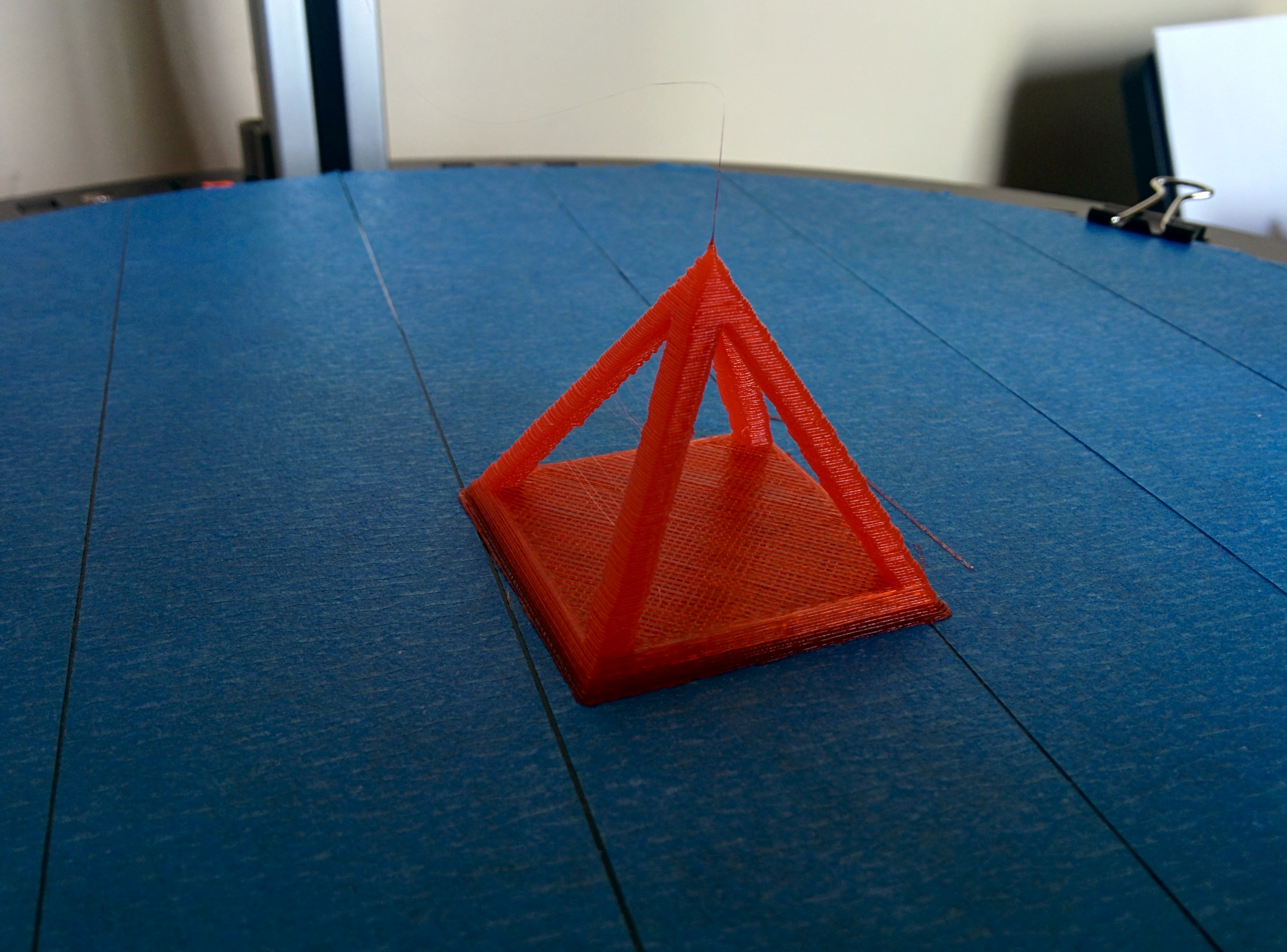

They're doing a pretty good job. Keeping the steppers warm to the touch, but not hot. My extruder is cranked up a little higher and is uncomfortable to the touch but not super hot.
That being said, I'm running into some problems right now with my layer alignment. I seem to have my retraction dialed in but my layers are all over the place. Take a look at the pic below of the hollow calibration pyramid:
Retraction looks great but the layers rarely align. Here's what I've checked so far to try to resolve the problem:
= Retension belts (they're very firmly tight now)
= Double checked vrefs aren't set too high (heatsinks are warm but not overly hot, no thunking audible for missed steps)
= Using trick laser arms so I'm pretty sure I don't have the delta arms blues (no arm binding and the effector plate moves freely in all directions) I'm also using their zero-lash straps (rubber bands)
= Ensured freedom of motion for the carriages (eccentric cam adjustments) and ensured that the carriages can only move up/down and not side-side or rotate at all
Any help or insight into the problem would be greatly appreciated -- it's so close to being 100% awesome!!
