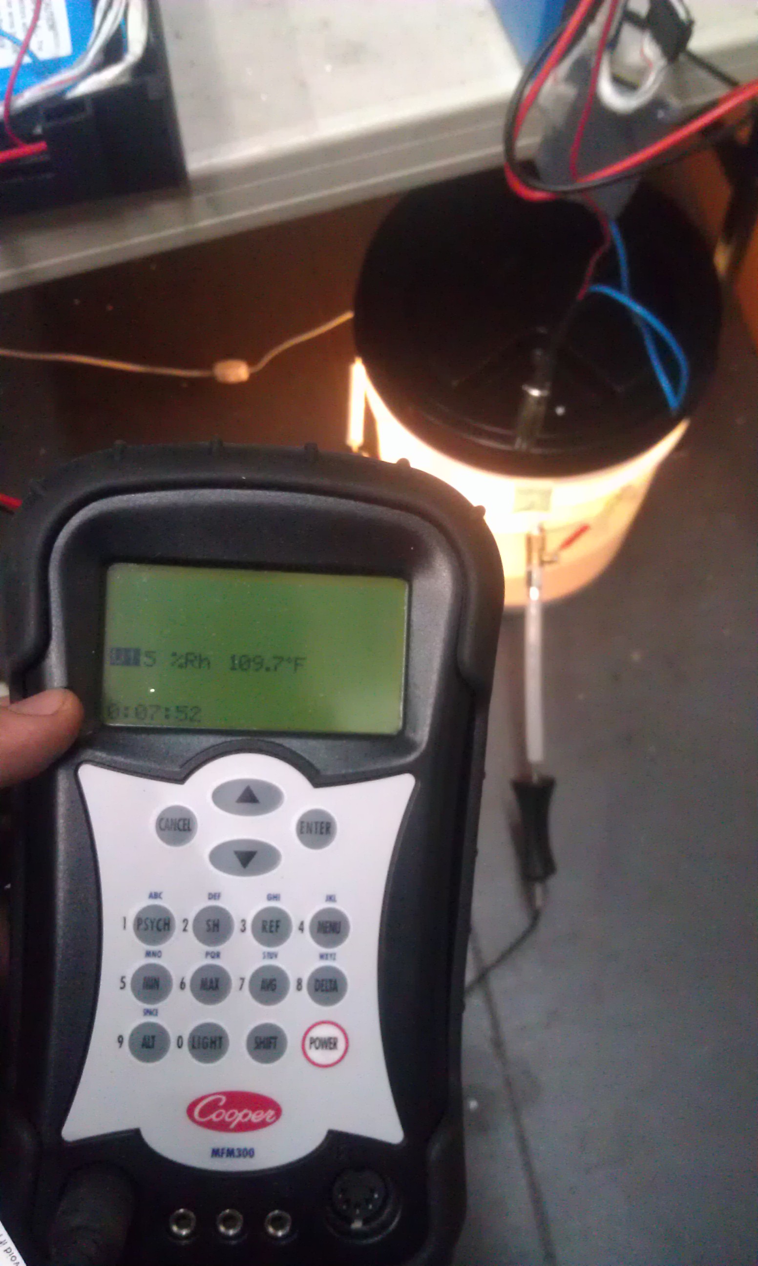

Re: My first Nylon fail!
Also, dry it, dry it, dry it!
I went a little overkill with my dryer box, but I had fun with it...
5 gallon bucket with a gamma seal lid. Got my hands on a super mist separator and a heated compressed air coupler. Hooked it up to a PID with a thermocouple. PTC inlet into the bucket, 1 way valve out of the bucket that releases at about 20psi.
A bed of about 1 inch of rechargeable desiccant at the bottom of the bucket. Spool of nylon sits on the desiccant.
Set the thermocouple to 200F for the alarm, and I pump the ultra dry, hot air into the bucket for an hour or 2.
If anyone knows of a more awesome way to dry filament, I'm all ears
Could you elaborate on the bucket you made that had the light bulb in it?cope413 wrote:Had to adjust my pressure down to 12psi...
It lasted a few sessions at 20, but eventually the lid popped off - couldn't handle the pressure. Had to replace it because it bent the tabs on the lid and it won't seal well anymore.
A couple observations from my drying trials...
1) While it may take 18 hours to fully saturate with moisture, 3-4 hours in 40-50% humidity is enough to negatively affect print quality
2) Well dried filament is smaller (duh) than wet filament - I had to adjust my flow rate up a bit to correct for it.
I'm in love with this nylon. It's awesome stuff.
I am interested in the bulb wattage and placement, how long it takes to dry the filament.
Did you use the fancy lid with the bulb version and what is a good source of the bulk desiccant and how
you recharged the desiccant. Pain in the you know what aren't I?
I apologize if you already covered this in one of your threads and I missed it.
Sure...
I got a simple bulb socket like this one http://www.homedepot.com/p/Westinghouse ... koMOoYm18E (mine was much older - salvaged from something long ago - but you get the idea)
I mounted it in a 3/4" PVC elbow with RTV silicone. I just filled it with as much silicone as needed to seal it. Then I used hot pipe glue to mount the elbow in the bucket. I did this so that I could point the bulb up or down in the bucket, rather than straight out where it could easily get hit by a spool coming in or out of the bucket.
I mounted it about 3" from the bottom of the lid, and angled mine down so the bulb is just above the center line of the bucket.
Before I got the compressed air moving through it, I was using a 40w bulb but it got too hot - I started to melt one of the spools in the bucket after about 2 hours. I dropped down to a 25w and that seemed to be good. I left it on for about 6 hours and there was no concern about melting anything unless it was directly touching the bulb.
I didn't want to mount the bulb in the lid for a couple of reasons...
1) the gamma seal lids are very handy for many uses and I didn't want to ruin one for no need
2) heat rises - didn't want the bulb to be at the top of the bucket
3) I don't like rotating anything with wires - the lid spins - so didn't want to deal with that
As for the desiccant, I had a half dozen of these guys from my days living on a floating house http://www.amazon.com/Hydrosorbent-Sili ... +desiccant
They're great. 1 would do the trick in a bucket, but I wasn't using them for anything else, so I went overkill.
Recharging is as simple as baking them in your oven for a few hours. 225F does the trick for me.
They change color when they're full of moisture, and go back to white when they're dry. No guesswork needed.
Just an aside - A 10lb bag of rice will set you back about $5 - works every bit as well as desiccant in this application - and can be recharged the same way, or just tossed and replaced.
If you're just using it for filament and you don't leave it out, it'll take you years to saturate the desiccant.
I'm still experimenting with drying, but if you had saturated filament and dropped it in the bucket, I would guess it would take you about 24 hours to fully dry it.
With the heated compressed air, it takes about 30-40 minutes - max.
I got my hands on a nifty piece of equipment last week when I got my dryer up and running.
Been running some tests on filament moisture levels and here's what I've found...
I tested 4 different filament samples.
All filament was thoroughly dried by baking in an oven for 18 hours at 185F.
Control sample was left out in the open air for 72 hours
Sample 1 - airtight bucket with desiccant, no heat - 72 hours
Sample 2 - airtight bucket with desiccant, 40w incandescent bulb - 72 hours
Sample 3 - airtight bucket with desiccant, heated and compressed air flow through the bucket at 3psi, 40w incandescent bulb. PID controlled compressed air heater set to 130F - once up to temp, air would kick on every 30-40minutes or so and would take about 6-8 minutes to turn back off.
My shop's average relative humidity over the past week was 44.6%.
I measured the Rh% of each bucket, and then immediately printed a cal-cube with it.
Control Sample:
Rh% 44.6
When left out for, the trimmer line still prints, but it gives prints a very different finish. It's actually kind of cool, but it's noticeably different. I didn't noticed any major issues with layer adhesion, but I definitely got "pops" which left some uneven spots. There was also a fair amount of blobs on corners, and on small radii I noticed a lot of stringing. Nothing that ruined the usability of a print, but definitely not ideal.
Sample 1:
Rh% 31.4
It printed cleaner than the stuff left out in the open, but not a whole lot. There was less blobbing on retracts, but still stringing and "pops" while printing.
Sample 2:
Rh% 18.3
Printed very clean for the first 30-40 layers. Beautiful. No popping, no blobs - just perfect. Started to get messier as it went. I surmise that the outside of the spool dried thoroughly and the filament on the inside winding didn't/
Sample 3:
Rh% 4.8
Perfect print. When I print with this stuff, I never want to print with any other filament again. Great appearance, prints like butter, and amazing strength. Great bridging ability, and excellent surface finish.
Preliminary conclusions:
Nylon absorbs a LOT of water if you let it. There's likely a sweet spot between my Dryer Bucket of Justice and Awesomeness and the simple bulb-in-a-bucket. While I'm thrilled with my results, it's not really practical. I suspect that keeping Rh around 15% with some heat will produce the same results if the filament is allowed to dry for longer periods of time. Ideally, the filament would feed from the bucket to the extruder without being exposed to the air.
I'll post some pics of the prints when I get my SLR and booth set up. Tough to show the differences in surface texture with my phone.
