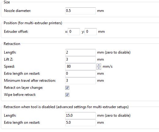

I have been lurking here on the forum quite abit in the last few weeks. I just got a RostockMax two weeks ago and have been having quite a few problems getting it to be consistent and need some help with getting the setup right if you can give me input.
So far here is what I have been getting out of it.
Here are my settings:
I am using PLA with 1.73mm avg line.
Any and all help would be appreciated.

So for temps I am really confused. I started out at 185, 190 but I was having a problem getting the first layer to stick to the print bed with glass or tape. So I was told to increase the temps to make it stick better. I am having a hard time with the settings because I am not sure what looks good and what each layer should look like.

Something else to note as well, I seem to be having a ton of trouble with small parts. I have the 0.5mm head on the printer, will it help a lot if I go to the smaller head before printing the smaller parts? It seems like it shouldn't matter..

Couple of things....
First, and most importantly, you need to calibrate your extruder. 92.65steps/mm is probably close, but it's not exact. Your print looks starved for filament. There's a sticky topic by Polygonhell about extruder calibration... it's very simple and straightforward, and it's an absolute must to get your printed dialed in and printing beautifully.
Second, try heating your bed to 55-60C, with tape. A little bit of heat can help with first layer adhesion.
Third, you're almost certainly running too hot on that filament. 190-210 is the general range, depending on where you get your filament. I use the Pro Series PLA from MatterHackers, and i'm printing at 190. I have previously used MakerBot PLA and was at 205-208. So there is a range. If your filament looks very shiny and curls up or gets stringy on corners or sharp angles, you're probably running a bit too hot.[img][img][/img][/img]
Fourth, smaller nozzles can help on smaller prints. I have both the .5 and .35 nozzles. It takes longer to print, but I definitely get cleaner, more detailed prints with the .35. It depends on what your "trouble with small parts" is, but it's likely not the nozzle. My guess is that you're printing too fast and/or too hot on small prints. For prints less than a few inches in diameter, try slowing print speed down to 10-20 mm/s, and make sure you have good airflow across the part. The hardest part with small prints is getting each layer to cool before the next one.
Lastly, every print is going to be a little different, settings wise. Because there are so many variables that aren't very measurable or controllable -filament temps, filament diameter, moisture content, etc - you'll often need to make adjustments on-the-fly.

Thanks so much for your input.
1. I have gone thru the extrusion calibration and it was very close. I will follow up on it again and see if I can get it even closer.
2. I will try my next print with the slower speeds and a heated bed to see what I get. I will keep you posted.
You said that you make tweaks as you go, after the print has started how do you make tweaks? Is that under the manual control and will that affect the whole print or just the current layer....

If you're using RepHost, then you can increase/decrease the Speed multiplier and Flow multiplier under the manual control tab. You can also adjust extruder and bed temps mid-print there too. Any changes you make will affect the rest of the print. I would suggest adjusting flow 3% a time. Also, keep in mind that there are 16 moves in the buffer, so when you make a change, the moves already in the buffer will not be affected, so you have to wait a few seconds to see the effects of your changes.
The other thing you can try for better first layer adhesion is to 1) increase your first layer temp 5-8 degrees, then dropping down after the first layer, and 2) decrease your first layer speed to 10-15mm/s.

I see something weird in your EEPROM. You have steps per mm set to 80 for all 3 axes. My setting is 53.33 because I have a RAMBo 1.0, which does 1/8th microstepping. Your board would be a RAMBo 1.1 or above, which does 1/16th, which means you ought to have a setting of 106.66. Yet, your bed height is realistic and your prints seem to be coming out mostly OK. Did you recompile your firmware with EEPROM turned on?
For PLA, you can print without bed heat if you have Kapton on your bed. This is a good way to print PLA because bed heat will cause the first few layers to expand and appear "fatter" than the rest, and if you're printing a vase or anything with sharp corners it will promote edge curling. It does require a better height calibration and to stop some pieces from lifting at the corners it may be necessary to spray some hairspray on top of the Kapton.
Another trick is to heat the bed to 60 degrees and then just turn it off after the 1st layer. Bed heat will make up for incorrect height settings and inadequate filament flow, up to a certain point, and I think it's somewhat easier to get that crucial 1st layer to print with heat on. (By the same token, you know your settings are pretty good if you can successfully print PLA without bed heat.) You can also get away with not having Kapton (or even hair spray) if your bed is 60-80. Use as little heat as you can while still getting the stuff to adhere, because bed heat is really not your friend with PLA after the first layer, and it takes a LONG time for that heat to bleed off after the heater is turned off.
Conversely, you need bed heat for printing ABS because it encourages the layers to bond. I think most people use 80-110 for ABS.

Thanks for the response and no I did not recompile my firmware with my EEPROM on. Should this be something that I change to make my prints better?
I have the latest version of Rambo.

When you calibrated your height, did you do so by editing the values in the EEPROM screen, and did it work? If so then your EEPROM is enabled.

New kits are shipping with 20 teeth, tooth? pulleys. 80steps/mm is correct.

When I calibrated my bed height I had to turn my EEPROM of and use the arduiono software to make some changes for my bed. It though that it was concave. I made the adjustments with the EEPROM off and then had to turn it back on. I had to make a minor adjustment but not much. Then I turned it back on as it instructed.
Did I mess something up?

IIRC, you can tell if EEPROM is enabled simply by it showing any values in RH (which you have screen shots of). But basically, if you're bed is flat and level I wouldn't worry about EEPROM or steps/mm
As far as adjusting printer_radius, you did it right. It has to be done in firmware. The rest can be done using EEPROM.
You're good
You sound like all of this is really new to you. If that's the case, the biggest piece of advice you can get right now is to focus on one thing at a time. It's incredibly easy to get distracted and start changing all sorts of things.
You're good
