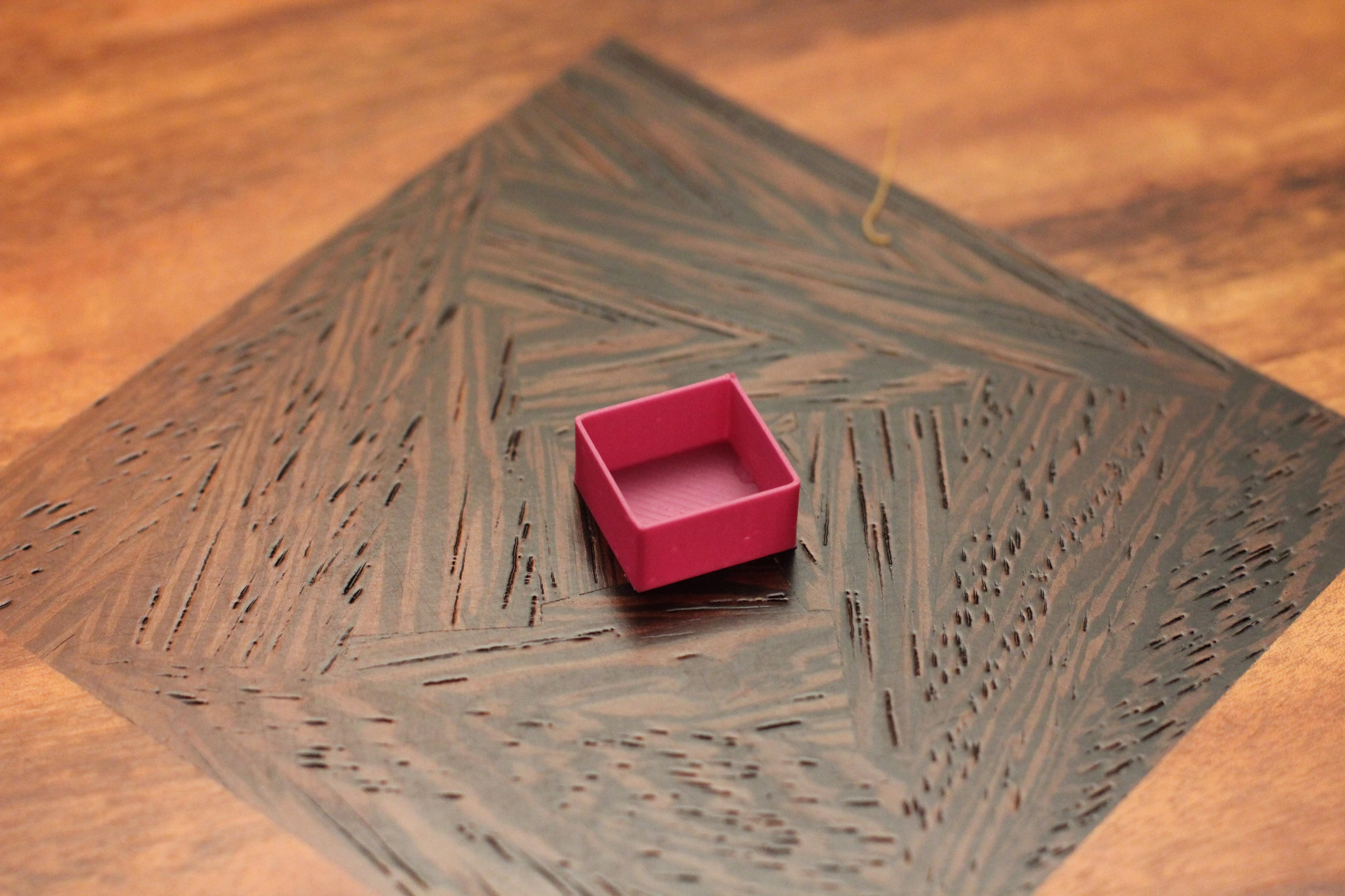

On July 17th, I took the delta arms off my printer. That started an odyssey of calibration, rebuilding, repairing, and upgrading that finally ended this morning at 12:15 AM when I successfully printed a calibration cube.
Here is the cube that I printed. It measures 20.00 mm across.
(Desk inlay not included.)
I typed in about four pages of text describing the ordeal in great detail. I edited it for two hours, then SeeMeCNC's web site threw the whole thing on the floor because I attached an oversized image. Bah. I'll repost parts of it someday. It's late now.
