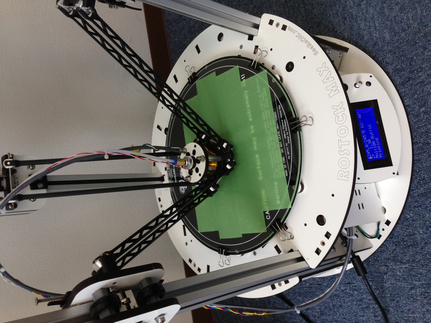

Looks, movements, and also sounds. I like all of them!
I'm tring Nylon printing, but here in Osaka, Japan, it might be a bit humid.

[youtube]http://www.youtube.com/watch?v=Y_3OWTmo7MM[/youtube]
Extrusion Temp : 245C
Heated Bed Temp : 40C
(using a glue stick and curing tape)
In the video, you can hear popping sounds.
Electric oven is useful for drying Nylon fillaments?
At the moment, I don't mind the influence so much.

A very nice machine!
Good job building and getting it calibrated.
Please be careful running with an Extrusion Temp : 245C
You are in the danger zone of melting the Peek plastic on your hot end.
Thanks for posting the great pictures.
