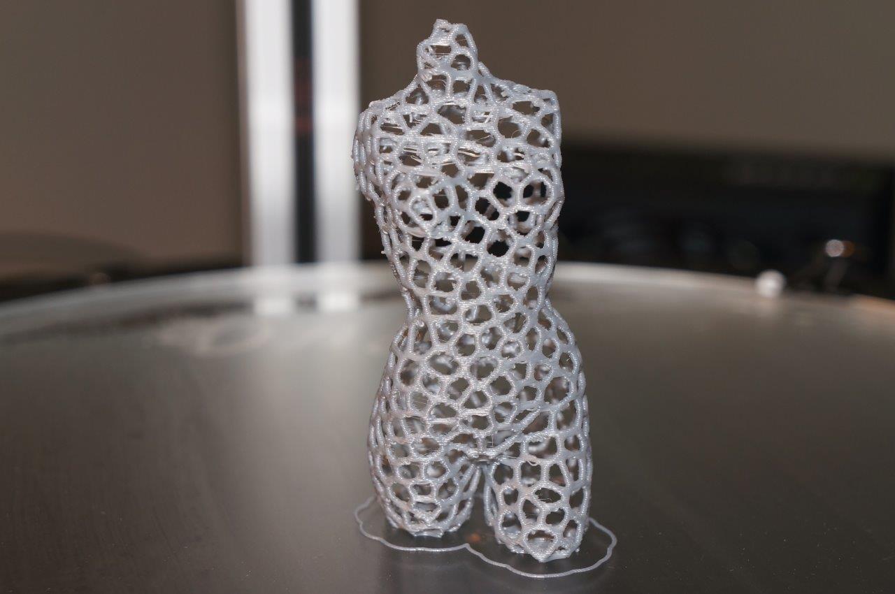

xnaron wrote:Because there are too many Yoda's...
Printed at 200mm/s in 45min. It is 100mm high.

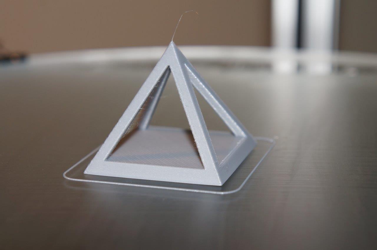

..all I want is to be able to print out a good bridge. Wow.
All the details are on the first page of this threadbplemmons wrote:Wow, that extruder looks amazing. you are really taking the Rostock to a new level..

with bridging it is important that you have your flow rate and nozzle size specified correctly. I always go about 10% higher for nozzle size (extrusion width). So for 0.5mm nozzle I specify it as 0.55mm. Just for fun try setting your extrusion width to 0.7mm and see how that affects your bridging.CosplayEngineer wrote:xnaron wrote:Because there are too many Yoda's...
