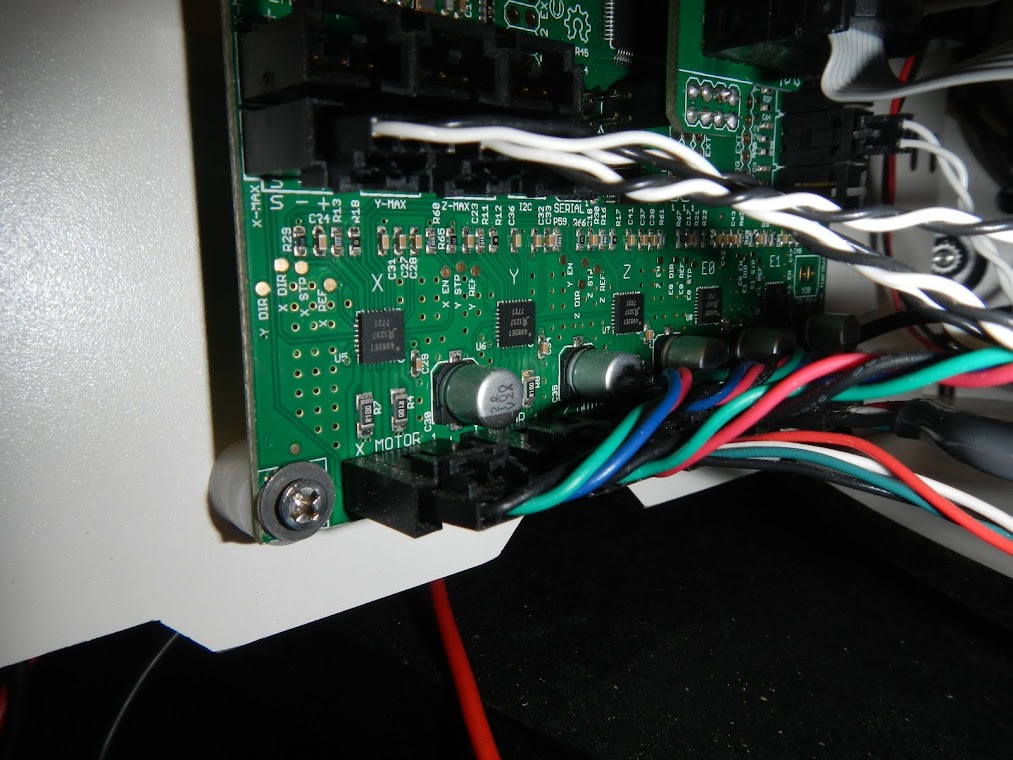

So I'm thinking that I fried some part of the RAMBo... I have control of all the motors through Repetier, and can heat up the bed, but the hot end temperature will not heat up. I confirmed that the hot end is functional by hooking it up to the bed output from the RAMBo and it started heating up. It seems that some component in the power distribution to the HEATER_0_PIN & HEATER_1_PIN on the board has been fried, but I'm no electronics board diagnostic expert so looking to the community to find out what I can meter out to determine the cause of the failure to replace it.

[img]https://lh4.googleusercontent.com/-D3J- ... CN9549.JPG[/img]
[img]https://lh4.googleusercontent.com/-R79b ... CN9550.JPG[/img]
[img]https://lh3.googleusercontent.com/-IJBm ... CN9551.JPG[/img]
[img]https://lh6.googleusercontent.com/-IhEB ... CN9552.JPG[/img]
[img]https://lh5.googleusercontent.com/-Iy6c ... CN9553.JPG[/img]

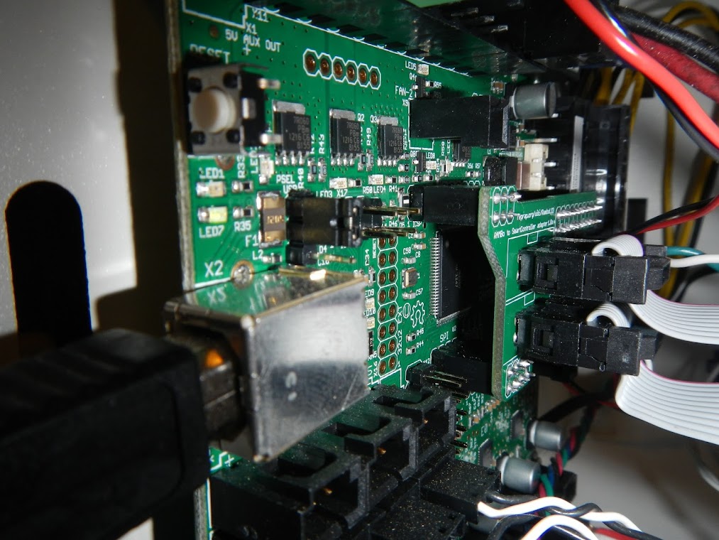

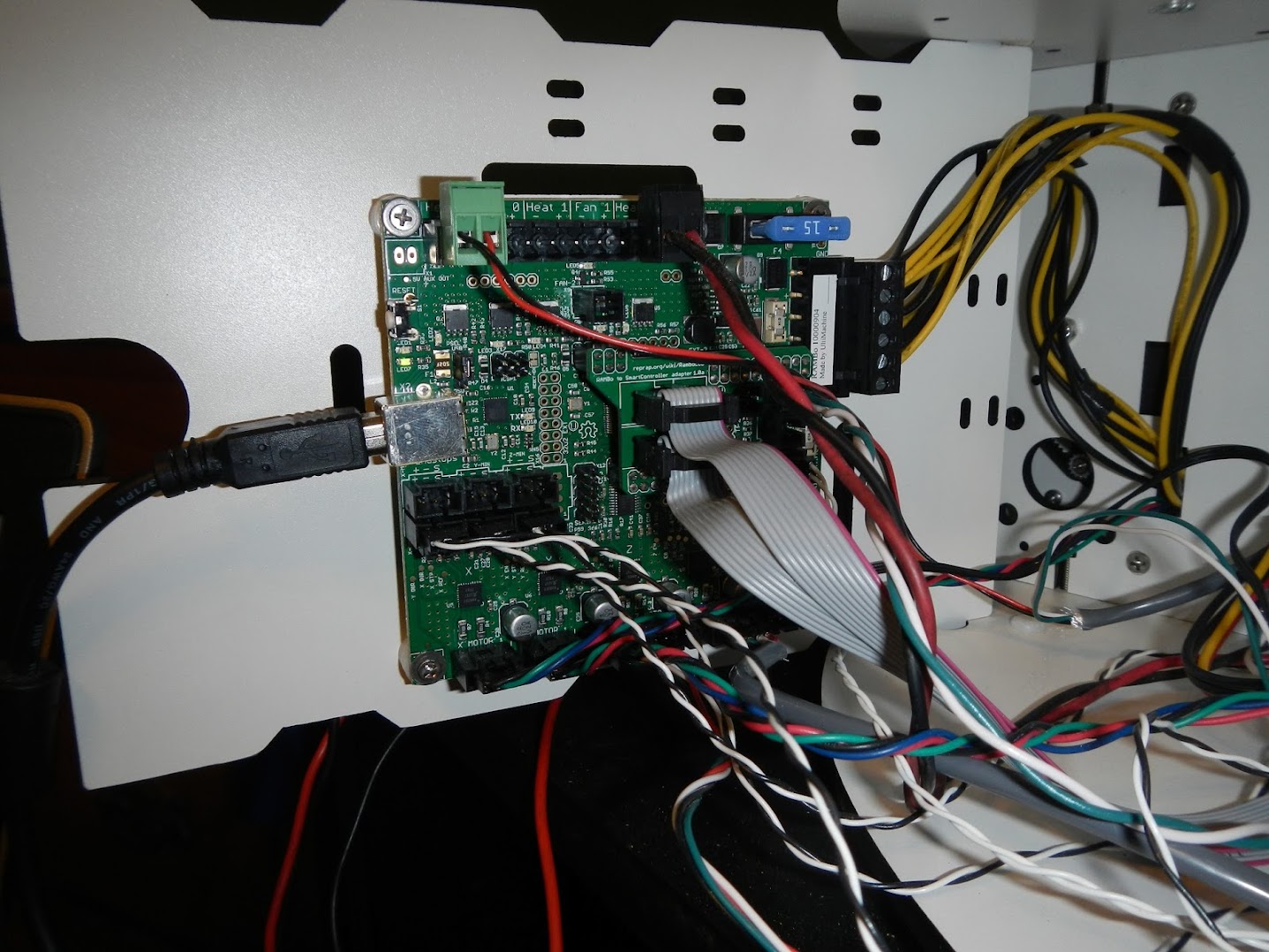

So the problem has been located... A burnt out fuse! :oops: I emailed seemecnc support and John came back with an answer lightening fast! I didn't even realize there were 2 additional fuses to the one large blade style fuse in there, so I was pretty sure that's what the problem was. Here's a pic showing the fuses and what I think they relate to. In the pic the motors & logic fuse is removed, the other one was actually the burnt out one in my case. I just had pulled them each out to test them both. I also included the fuse part number I got from ultimachine https://ultimachine.com/content/fuse-0448005mr ($1). And a link to a ever so slightly cheaper one from Mouser electronics... http://www.mouser.com/Search/ProductDet ... 0448005.MR ($0.72). I went ahead and ordered 3 just in case I need one in the future, since they were so cheap
[img]https://lh3.googleusercontent.com/-qFKU ... /photo.jpg[/img]
I did rig up a test to make sure that it was just the fuse was bad using a similar fuse, a glass tube style fast-acting 125V 5A from Radio Shack. I just soldered some wire to each end of the glass tube fuse, and afixed the other ends of the wires to some leftover plastic from previous prints that I was able to trim to the same size as the fuse. Sometimes it's nice to have a lot of test prints lying around, not the first time those have come in handy! After putting that fuse inline the heater was back to working normally :D
And here's a close-up of the fuse that tested bad... No visual indications, must be pulled from the circuit and checked with a meter for continuity across the terminals
[img]https://lh3.googleusercontent.com/-GeQq ... CN9563.JPG[/img]
