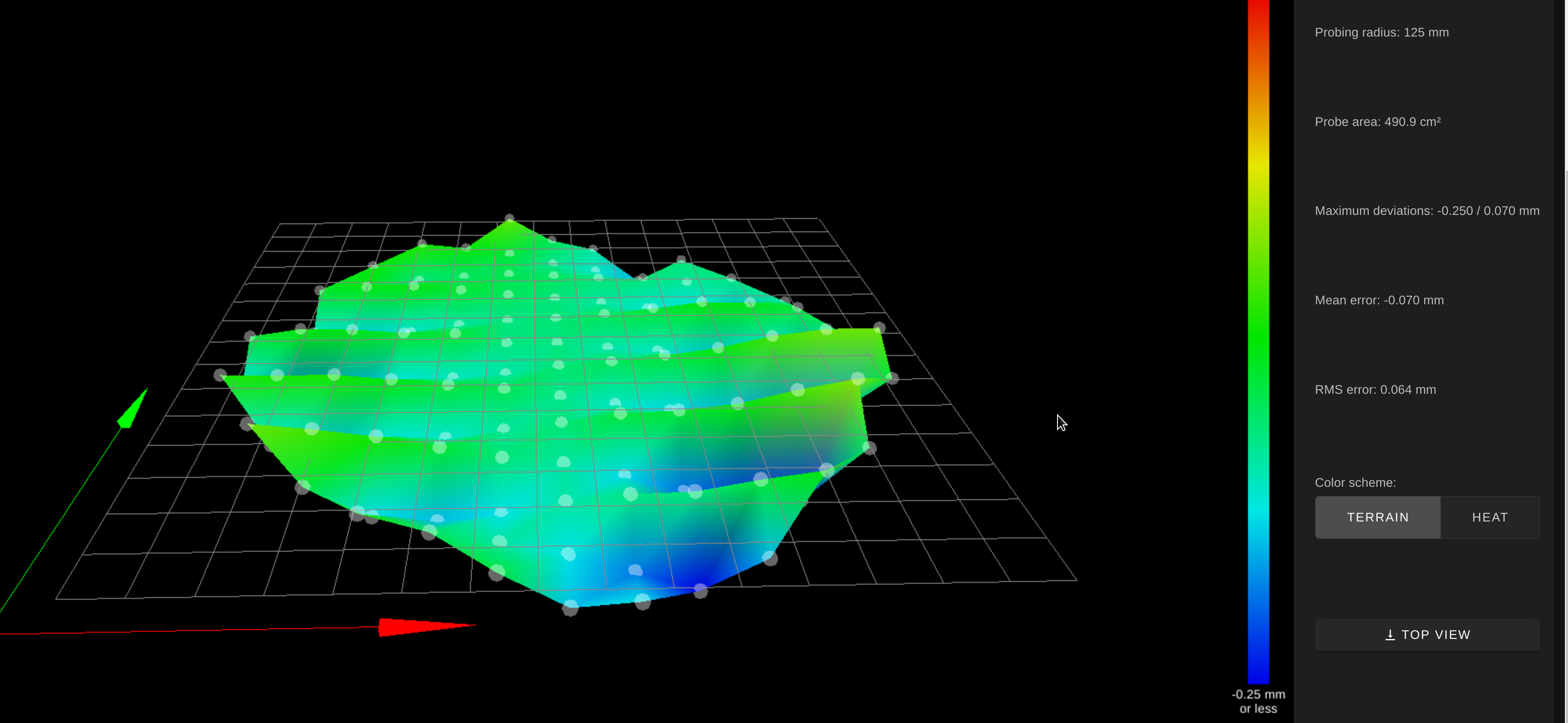

First question is on belt tension again as I've had this problem with my V2 build, now its been upgraded to a V3.frankenstien. I had to have the belts extremely tight to solve it. I had actually cracked a skate at the belt clip. Should I be able to get enough tension by twisting the motor with a thumb and forefinger?
The problem I'm having is peaks and valleys in the bed map. It's actually worse than it's was before. viewtopic.php?f=37&t=12768 sadly all the pictures have timed out. Here is my bed map now. Manual says tight enough they don't slip, I'm passed that to get this good of results.
One other concern is how tight the CF arms are on the metal balls. I might swap the plastic ones back in to see if that is adding to much of a bind.
I kinda hate to call this backlash because it's not that simple, it's related to the last direction moved. Here is a macro I have to test for it a each tower. If someone doesn't mind run this and post the results. This is a duet with a smart effector.

Here is my results now,
Code: Select all
5/8/2020, 7:49:11 PM: M98 P"0:/macros/xyzTowerBacklash": G32 bed probe heights: 0.054 0.074 0.089 0.089, mean 0.077, deviation from mean 0.014
5/8/2020, 7:49:20 PM: : G32 bed probe heights: -0.191 -0.186 -0.191 -0.191, mean -0.189, deviation from mean 0.002
5/8/2020, 7:49:31 PM: : G32 bed probe heights: 0.076 0.091 0.096 0.116, mean 0.094, deviation from mean 0.014
5/8/2020, 7:49:40 PM: : G32 bed probe heights: -0.204 -0.224 -0.229 -0.249, mean -0.227, deviation from mean 0.016
5/8/2020, 7:49:51 PM: : G32 bed probe heights: 0.037 0.052 0.057 0.052, mean 0.049, deviation from mean 0.008
5/8/2020, 7:50:01 PM: : G32 bed probe heights: -0.283 -0.283 -0.308 -0.308, mean -0.296, deviation from mean 0.012
Cory
Boring details. This was a v2 with a duet. It's now a V3 frame, ac heated bed, .9deg steppers, metal ball joint, CF arms, smart effector, maker713 effector mount, 24V power supply.

geneb wrote: Sat May 09, 2020 10:53 am Flip the glass upside down and run it again. Different results?
I've tried it with and without the glass, same result. Also that backlash macro shows that it's not on the bed.
Cory

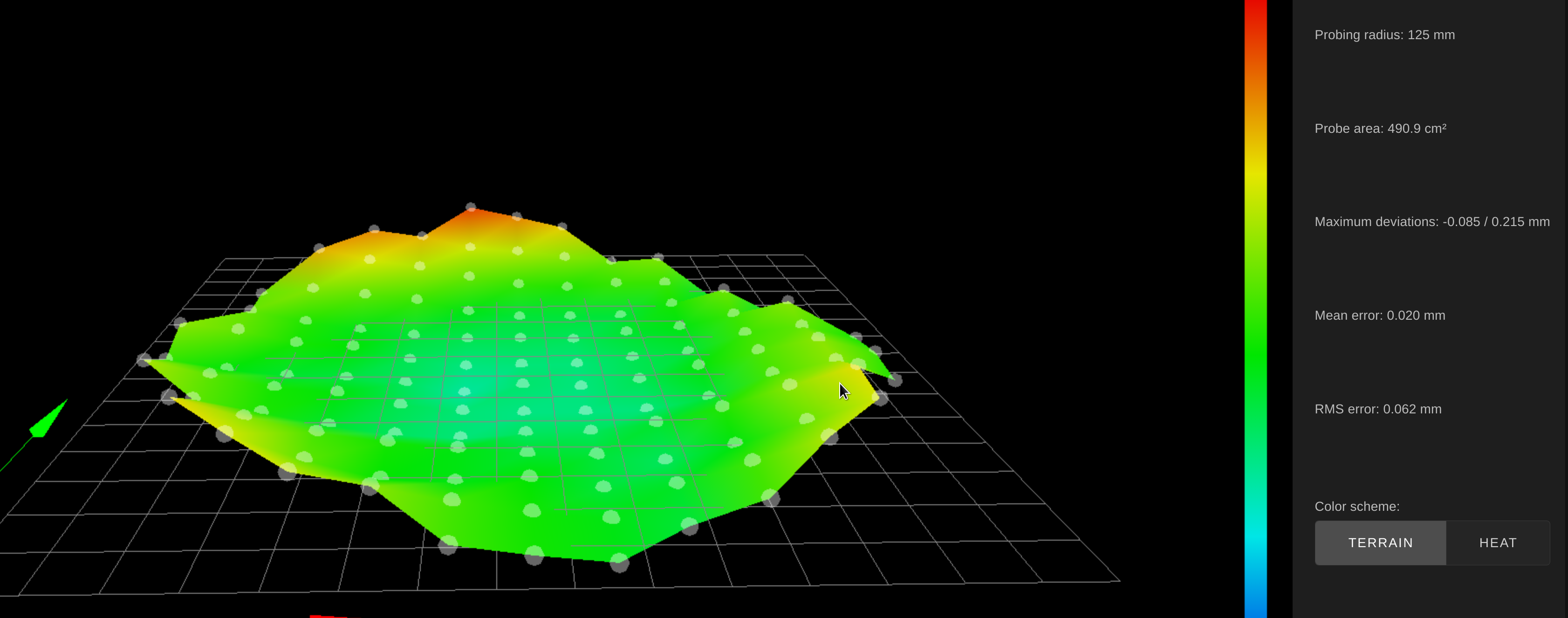

Okay, I found it. After picking the wrong place to start(belt tension) I decided that the only thing it could be was the tight arms. I swapped the plastic balls in instead of the aluminum ones. Much much looser. The CF arms are from the previous build, the aluminum balls are new. I can't see any difference with calipers between them, so the difference must be in the arms causing some to be so tight. Some have more wear than others obviously. I did use the grease.
Code: Select all
5/10/2020, 4:01:22 PM: : G32 bed probe heights: 0.114 0.094 0.089 0.089, mean 0.097, deviation from mean 0.010
5/10/2020, 4:01:32 PM: : G32 bed probe heights: 0.049 0.054 0.049 0.049, mean 0.050, deviation from mean 0.002
5/10/2020, 4:01:42 PM: : G32 bed probe heights: 0.114 0.119 0.114 0.114, mean 0.116, deviation from mean 0.002
5/10/2020, 4:01:52 PM: : G32 bed probe heights: 0.094 0.094 0.089 0.089, mean 0.092, deviation from mean 0.002
5/10/2020, 4:02:02 PM: : G32 bed probe heights: 0.152 0.157 0.152 0.137, mean 0.149, deviation from mean 0.008
5/10/2020, 4:02:12 PM: : G32 bed probe heights: 0.072 0.077 0.072 0.077, mean 0.074, deviation from mean 0.003
That's calibration, pretty sure I can get that bed map worked out. Any know methods to loosen up the ends of the CF arms?
