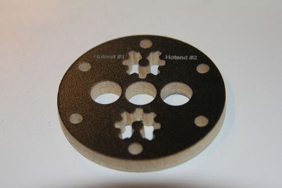

Re: Dual Extruder
Post by gallenat0r »
I found the files on github and have made the files for the mill. Will post a picture when milled :)
gallenat0r
gallenat0r
Posts: 7
Joined: Thu May 02, 2013 9:35 am
Re: Dual Extruder
Finally got the time to mill :)
If anyone wants one or wants the files, let me know.
gallenat0r

Re: Dual Extruder
Post by LorenOlepi »
Nice job! what are the gear shaped cutouts for?
Posts: 5359
Re: Dual Extruder
The gear outlines are the Open Hardware logo.
Essentially means, "this design is open source, enjoy it, hack on it, improve it!"

cambo3d
Posts: 1057
Location: Florida
Re: Dual Extruder
Post by cambo3d »
not to sound like a salesman here. but i could make these in aluminum so it acts as a heat sink to the hot ends also.
mine gets fairly warm at printing temperature, using a fan with heat sink mount will help dissipate the heat off better.
if you want to make one yourself here is a dxf file for mine.
dual hotend Adapter Plate.dxf
(12.78 KiB) Downloaded 274 times
