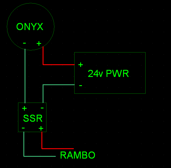

awhile back I upgraded my onyx 12V bed to 24V using 35amp power supply and SSR. My problem is that I my SSR's keep malfunctioning where the SSR will stay in the closed position permanently. Checklist:
1. does SSR have acceptable current rating. Yes, I have used 40A and 100A with same result.
2. Is circuit wired properly. Yes, I have triple checked. this. Bed indeed heats, Led lights, but it does this no matter what input side of SSR is doing.
3. I have not put a fuse inline yet. maybe I should
Question, I am purchasing fostek SSR's from amazon. Could this be the issue? My SSR's are just junk and I am throwing money down the drain? Has anyone else been experiencing this issue?

Swap the wires on the output terminals. They are not interchangeable.

I don't think you're blowing anything. Heat stuck on is exactly the condition I had when my SSR was wired the way yours is. Swapping the output terminals left it functioning correctly.
Another thing... You can't ohm out the bed while it's connected to the circuit.

Since this much heat (500W) could start a fire I chose to spend the extra $$$ on the Crydom from Digikey. I also built a safety circuit using a normally open 24V relay and thermal fuses. The circuit is below. I run 24V through a chain of 150C thermal fuses to power the NO safety relay coil. If any of the fuses blow due to an over-temp then the relay shuts off and opens the circuit to the SSR and bed. I sleep MUCH better knowing there are thermal fuses on the bed (two on the bed in series) and one on the SSR. I used Permatex Ultra-Copper high temperature silicone to glue the thermal fuses in place.
http://www.digikey.com
Thermal fuse: 317-1136-ND
Safety relay: PB1012-ND
SSR: CC2158-ND
The SSR can go on the 'high' or 'low' side and I chose the 'high' side. It isn't supposed to matter which side you use, but with cheap imitation SSRs out there they may not like one type and fail. I also added a 1k-ohm resister between the control inputs on the SSR to make sure the input is pulled low when the RAMBO signal is off. This may be overkill but it doesn't hurt.
I also found that the switching speed of the RAMBO to the heated bed is very fast, about 2 kilohertz. The Crydom just barely reaches this speed even though the rated frequency is 0.9 kilohertz. It works for me using the stock RAMBO firmware, but it may not work well on other brands of SSRs. I agree that bang-bang would be the place to start with other brands of SSRs.

Thank you for the valuable input on this. I have resolved this issue using the instruction gained here.
1. bought Auber relay. DC DC 100A. (actually bought 2 just in case) Thanks Xenocrates!
2. boughht new Onyx ver7. However, after removing original from system I did a new resistance check. it appears to be ok. I am not sure why I was seeing the odd reading previously. Maybe I was reaading while it was still hot.
3. I am now convinced it was indeed the garbage SSR's I was purchasing from amazon. Lesson learned.

Has anyone put a scope on the circuit?
Perhaps there is enough inductive kickback to eventually kill a cheap SSR. Maybe just need a snubber circuit.
