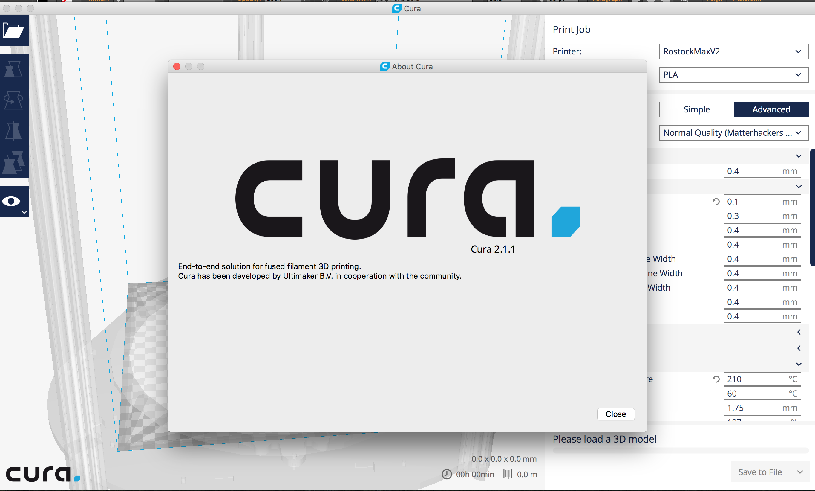

I have been playing around with the latest release of Cura and I agree there are a lot of great settings to play with and a lot of potential. I am fairly new to 3d printing but have a programming background so I wasn't afraid to take a stab at the json files and configuration to make the Max v2 work with cura since it seems support for delta printers was removed in the last few updates. I actually got it so I could add a custom printer profle, and slice and start a print, but that is where I ran into some issues. I'm working on a mac so I'm not sure the path for windows but if you want to add your Rostock to Cura follow these steps:
  • Open Finder and navigate to applications
    Right click on the Cura app and select "Show Package Contents"
    Navigate to Contents->Resources->cura->resources->machines (this is where the json files for each printer are stored)
    Add the RostockMaxV2.json (attached) file to the machines folder.
    Navigate to the meshes folder. (should be just below machines)
    Add the rostockmaxv2.stl to this folder. (this loads the printer image into the cura preview, well part of it. I put just enough so you could get a good perspective.)
    Now open up cura and add a new printer. You should see the option to add your Rostock now.
The json file has a disallowed areas setting which is how you make the print bed circular. Where I am stuck is on the machine start and machine end gcode settings. I basically used the gcode from matter slice, but what happens is when I tell cura to print it sets the heatbed but doesn't heat the hotend. I have to manually do that, and every time I go to print my print head heads all the way over to the end of the plate between y and z towers and just sits there and extrudes. If someone out there with more knowledge can help with the start, end, pause, resume codes, and the overide settings I think we can get a good working solution for people that want to use Cura and their Rostock.
RostockMaxV2 copy.json.txt
(6.38 KiB) Downloaded 728 times
rostockmaxv2.stl
(6.88 MiB) Downloaded 622 times

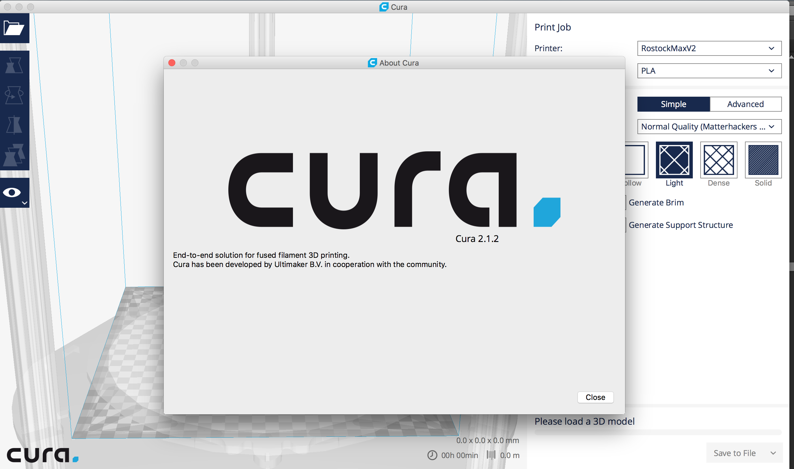

Nylocke
Posts: 1418
Location: Iowa
Re: New version: 2.1.2
Post by Nylocke »
I'm also on OS X so I'll try messing around with it. I'm pretty sure I know whats wrong and I can check it out soon.
edit: which version are you using? I have 2.1.2 and I put the .json file in the correct spot (new location is Content/Resources/cura/resources/...) and I edited it so the center is 0,0 (main mistake in your config that was causing the printer to move off to the corner), but the printer won't show up in Cura when I go to add a new printer.
greyghost
Posts: 16
Joined: Wed May 11, 2016 10:29 am
Post by greyghost »
Nylocke wrote:I'm also on OS X so I'll try messing around with it. I'm pretty sure I know whats wrong and I can check it out soon.
I'm running 2.1.1, and you are right I forgot to add the extra resources folder in the path. I just updated to 2.1.2 and if you use the json file and stl I provided you should still be able to add the printer. Where and how do you set the center to 0,0?
I've found that the printer not showing is usually due to an error in the json structure. Also make sure you remove the .txt extension. I only added it so I could upload the file. For example the machine_start_gcode and end_gcode have to all be on one line. If you multiline it the printer won't show up. You can use jsonlint to check that. I use sublime text 3 so to make changes what I typically do is multiselct all the \n on the machine_start_gcode settings and put them all on their own line. Then I reselected and fn delete which puts everything back on one line.
I also have found that getting cura to recognize the printer has been kind of a challenge. I usually have to turn on the printer, plugin usb, insert sd card in printer, remove sd card then the print to usb will show up. Also I find the print window very lacking. I'm guessing this is due to lack of support. It basically shows the element and bed temps and that's it. I'd love to have more info and the gcode is suppose to generate it but I'm not sure why it isn't showing up.
