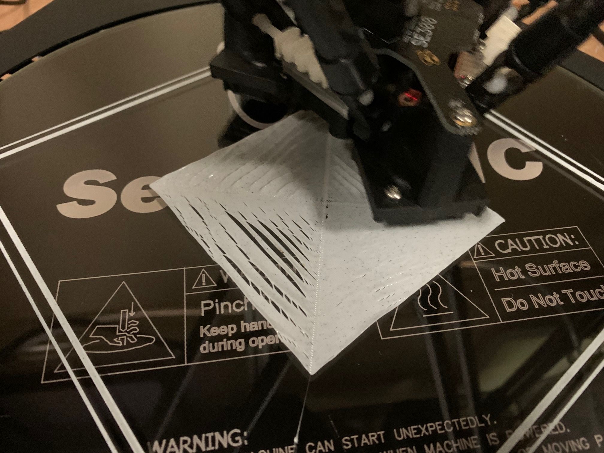

Re: Parts of first layer look bad
Its weird, if I use a raft the 1st few layers look awesome! See picture, then when it gets to the model the same thing starts happening, it eventually fixes itself by adding more layers which smooth's it out but this is weird. I wonder if I have some cura settings that are off ?
so should I run the first probe macro ?? or the _probe Autolevel ?
I have the Artemis 300. I am using atomic filament but lately, the first layer has parts that look like crap, see picture. The bed is clean, I have poked a thin acupuncture needle through the hotend to make sure it is clear. Anyone have any idea's ??
