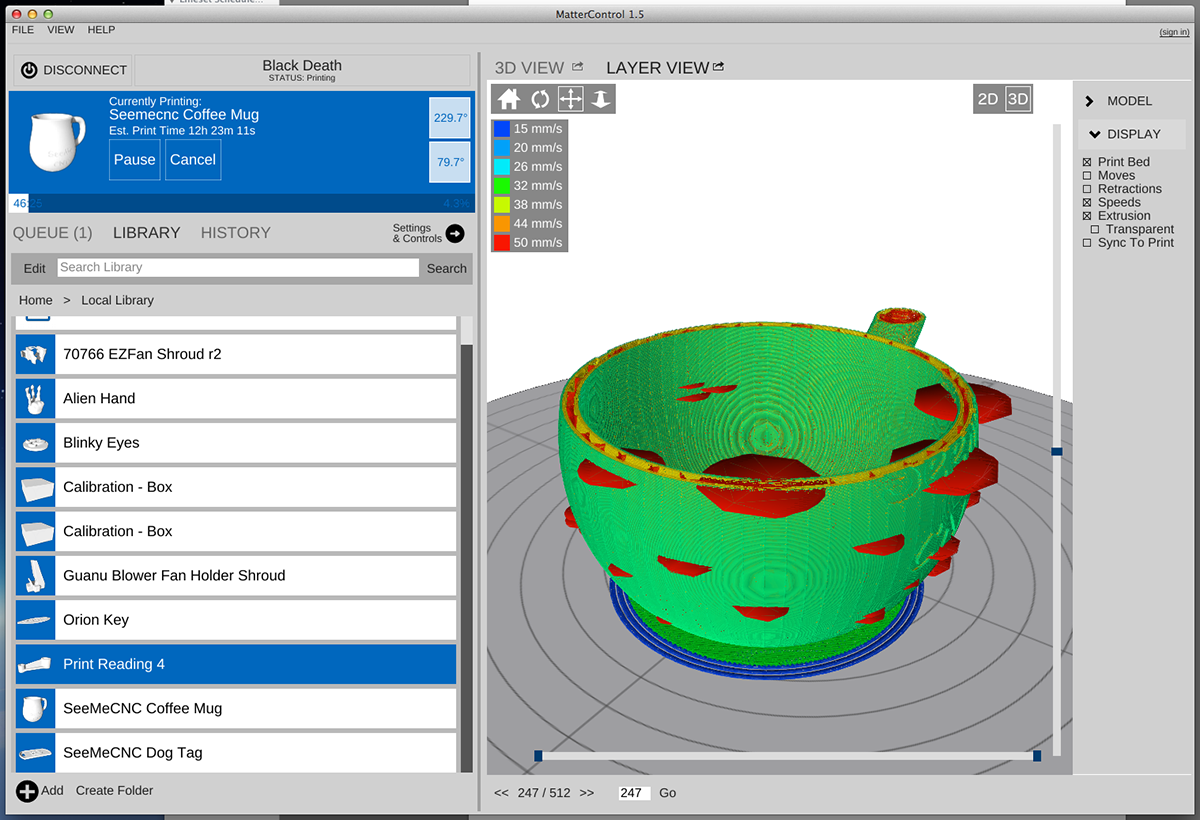

Plus: if you're going to play in the world of manufacturing on a Mac, don't do what I did..... Get yourself a copy of Windows (licensed, if you must) and install it on a VirtualBox VM on your machine. AAMOF, I have a licenced Win7Pro install runnning natively in a Bootcamp volume on BookZilla ...

Re: Rendering Artifacts?
Captain Starfish wrote:I'd say install a copy of the free netfabb tool...
Nope... No Mac version.
geneb wrote:If you need a nice, free tool, try DesignSpark Mechanical.

Mon Mar 28, 2016 1:02 am
Forum: MatterControl
Topic: Rendering Artifacts?
Replies: 8
Check this out...
See the red circles in various layers? What the heck is going on there? I opened the STL files in Sketchup and the polygons all look fine...
IMWTK...
by The Rigger
