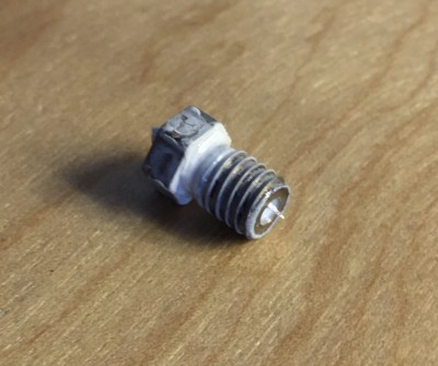

I did tighten the nozzle at temp... I think it was around 210 or so. Held the heater block with a wrench while tightening. And that's why I was surprised to see leakage. I actually had no trouble removing the heat break after all had cooled down.

Doesn't seem to be anything unusual, but I've never looked for this sort of thing before. You can see the melted PLA all over the threads.

After recalibrating for the filament diameter and running a test print, noted that there was melted filament oozing out of the heater block above the nozzle. Shut everything down, disassembled the hot end again , and replaced the no-stick stainless nozzle with a stock 0.4mm brass nozzle. All is well ...
