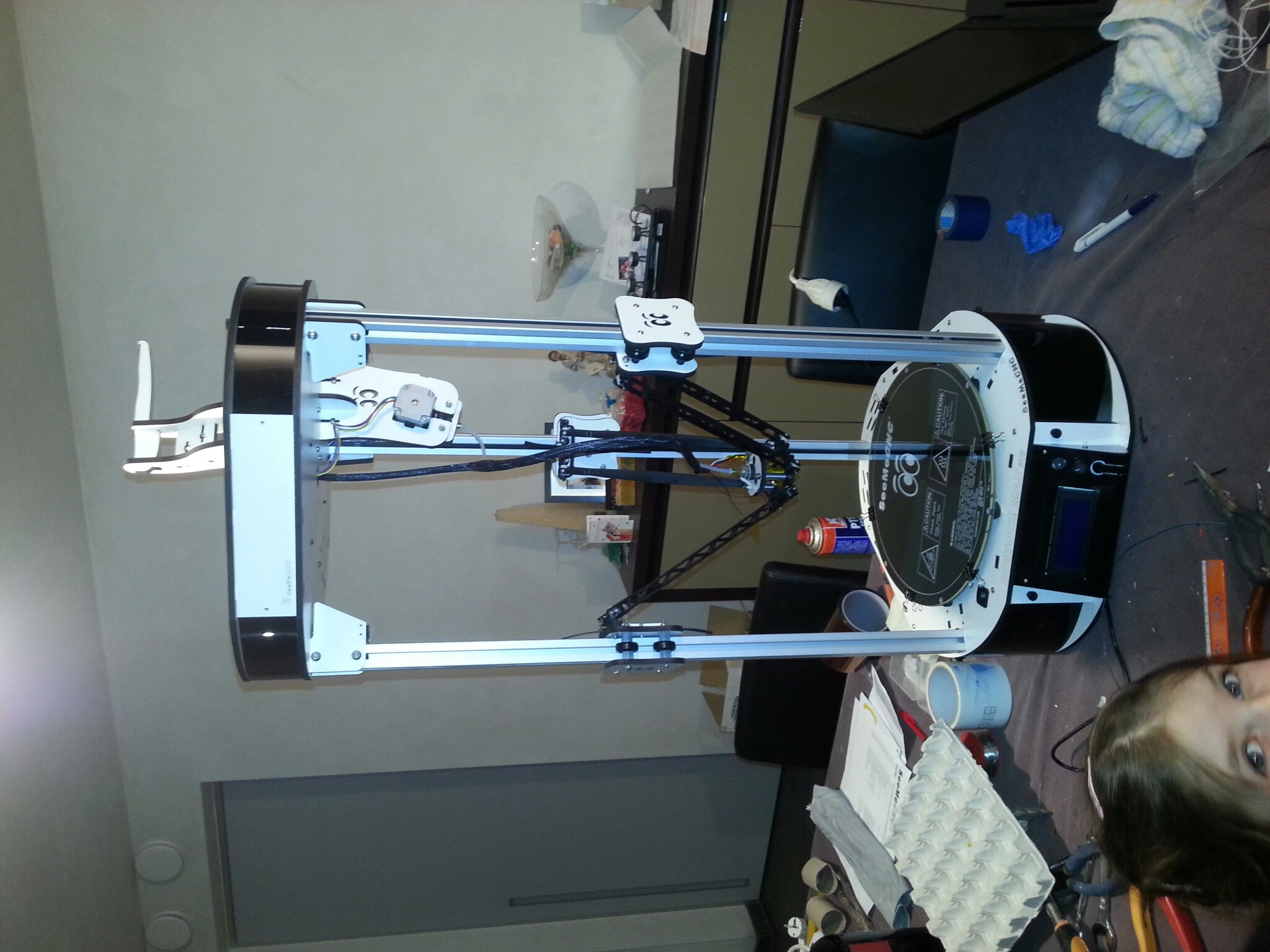

I found the problem! Posting this so you don't have to go through the same hassle as I did. The problem was that the filament guider got stuck behind the X-axis cheapskate carriage (see photo). This pulled the X axis carriage and consequently gave it an offset, which translated in an X, Y and Z ...

Hi, two weeks ago I assembled a Rostock Max v2 and in the meantime, I made some nice prints. Great 3D printer btw and excellent assembly manual! So I'm relatively new to 3d printing, but I made more than 10 objects without major problems up until now. Today I decided to make something 'slightly ...
