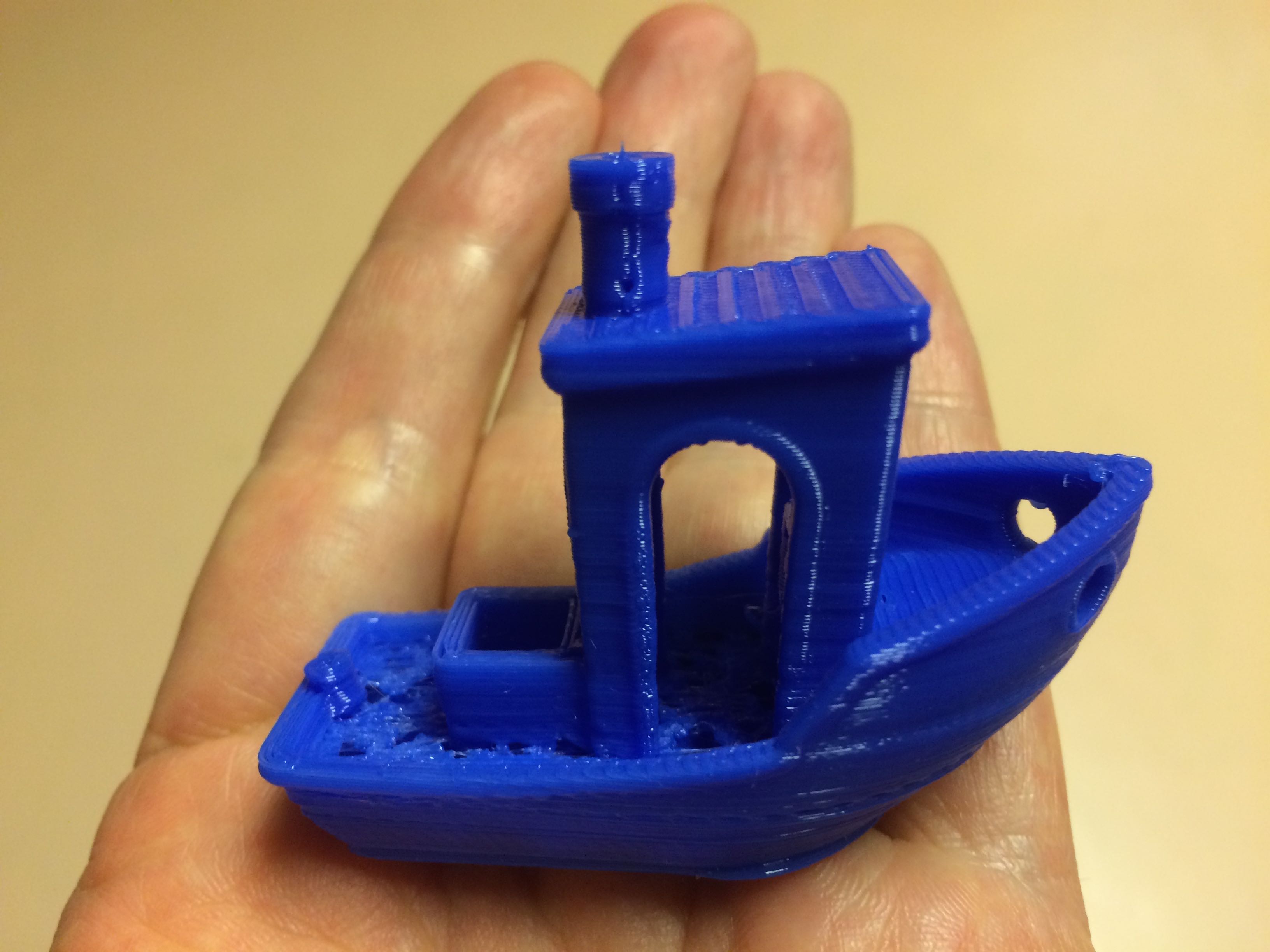

Here is my 3DBenchy. MatterControl/MatterSlicer in PLA with all stock parameters.

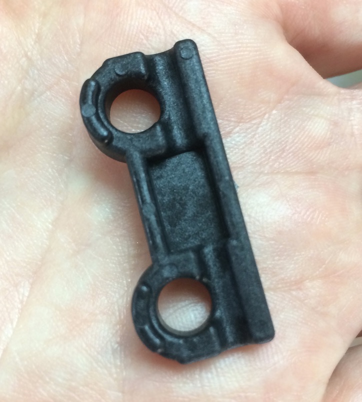

And here is my third print, part of a CowTech 3D scanner. My H1.1 was never this good, reliable, or easy to use.

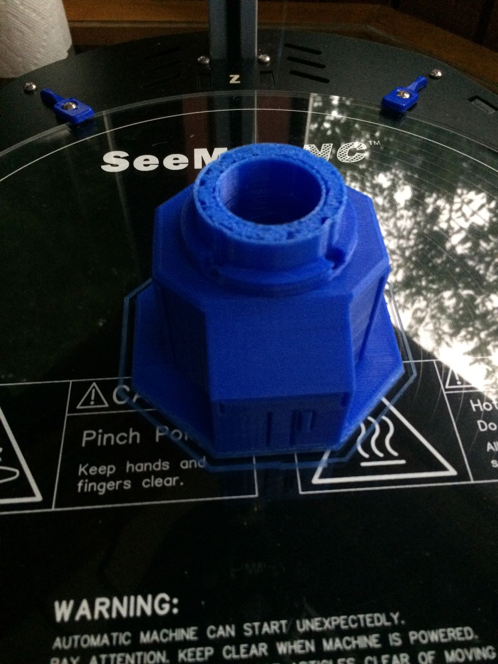

Printing the calibration brick that comes with matterControl, on unadorned glass, standard settings on the standard slicer. SImulating the the stock experience for a first time printer.
